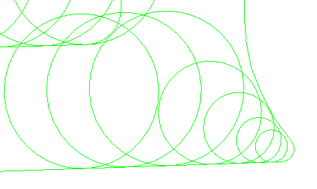

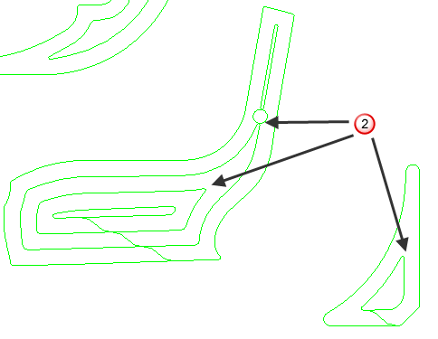

Maximum overload of 10%
LinksSmooth
When the tool approaches overload, a trochoidal path is inserted to avoid the overload.
— Narrow channel
— Sharp corner
Looking in at a corner in even more detail, you can see the trochoidal path more easily:
Note: Because some tool overload may be acceptable, it can be controlled by the Maximum Overload value. The default setting for the allowable overload is 10% of existing stepover. So, if you use a stepover of 10 and an allowable overload of 10%, trochoidal moves will not start appearing until an overload condition of 10% is exceeded.
