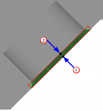

Center X1, Center Y1, Center Z1 — These fields display the X, Y and Z coordinates of the center of one end of the conical surface. By default, PartMaker chooses the end of the conical surface that should be used as the point of tool entry, taking into consideration the orientation of the conical surface and spindle type of the face window.
Center X2, Center Y2, Center Z2 — These fields display the X, Y and Z coordinates of the center of the second end of the conical surface.
— Tool orientation for Center 1.
— Tool orientation for Center 2.
