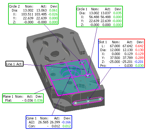

Labels are displayed for all the items that can be seen in the CAD view. For example:
The measurements associated with each item are displayed in labels, together with an arrow that identifies the feature the item refers to. If you have chosen to compare an item's measurements with its nominals, the labels can also display the nominals, and the values are colour coded to indicate each measurement's status:
- Green indicates the value is within tolerance.
- Red indicates the value is above tolerance.
- Blue indicates the value is below tolerance.
- Black indicates the value is not measured (such as for constructed items) or the value has not been compared with its nominal.
The label borders are also colour coded. When some of an item's measurements are above tolerance and some of the measurements are below tolerance, the label border is displayed as a mixture of colours.
