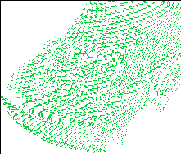

If the registration process is successful, the inspection sequence is updated, and the results are displayed in the CAD view. For example:
