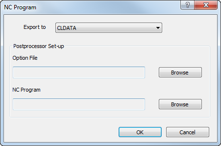

Use the NC Program dialog to export a Delta Transformation item to an NC program.
To export to an NC code:
- In the Delta Transformation dialog, click the Export to NC code
button. The NC Program dialog is displayed.
- Choose an option from the Export to list. Select:
CLDATA to generate an NC program file. Use the upper Browse button to select the PostProcessor option file that is configured for the machine-tool controller you are using; use the lower Browse button to enter the NC program file name.
- a name of a template file for the machine-tool controller you are using to create an NC program file.
- Click OK to export the NC program and close the dialog.
