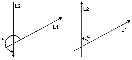

The angle is measured from line 1 to line 2 using the parts of the lines nearest their direction arrows. To change the angle reported, use the
Invert vector
button to change the direction of the line vectors, as was done in this example:
