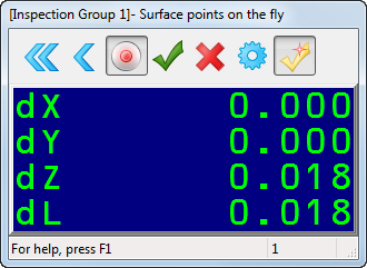

- Click Form tab > Surfaces panel > On-the-Fly Point. The Surface Points on the Fly dialog is displayed.
- Probe a point on the surface you want to inspect. A disc is displayed in the CAD view to indicate the location of the probed point. The deviation from the nominal is displayed in the Surface Points on the Fly dialog. For example:
The colour of the disc in the CAD view and the dL value in the Surface Points on the Fly dialog indicate whether the point is within tolerance (green), below tolerance (blue), or above tolerance (yellow).
