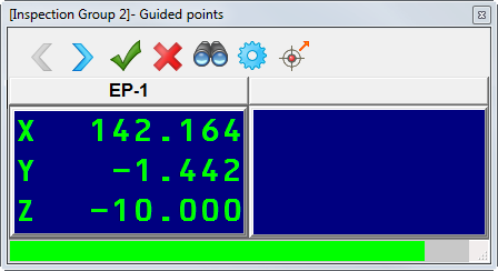

Create a Guided Edge group and play it. The Guided Points dialog is displayed, and a yellow triangle is displayed on the surface.
- Probe a point on the surface near the triangle. The position of the point is displayed on the left of the dialog, and a bar at the bottom of the dialog indicates how close the probed point is to the guided point.
You cannot take the point until the probe is within the Proximity criteria specified in the Measurement Parameters dialog.

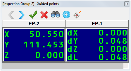

- Probe a point on the edge at the yellow triangle. The triangle changes to green and the deviation of the edge point is displayed on the right of the dialog. In addition, the position of the next guided point is displayed on the left of the dialog, and a yellow triangle indicates its position on the part.
- Click
to save the edge point measurements and probe the next edge point.
