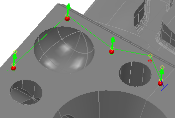

To create the points in the probe path for a surface inspection group:
- To add a guided surface point, double-click the model. A red sphere is displayed at the probing position, and the approach point is shown as a yellow diamond.
- To add an intermediate point, move the cursor over the path or over the extensions from the first and last points in the path. When a grey diamond is displayed, click the diamond, drag the point to a position, then release the mouse button. The diamond is displayed in yellow. By default, the extension from the last specified point is highlighted in blue.
- To insert a guided surface point within the probe path, click the path, then double-click the model.
- To insert an intermediate point within the probe path, right-click the path, and then select Split from the context menu.
- To move a guided surface point, click the red sphere, drag the point to its new position, then release the mouse button. Alternatively, right-click the sphere, select Edit from the context menu, then enter the position in the Point Coordinates dialog.
- To move an intermediate point, click the yellow diamond, drag the point to its new position, then release the mouse button. Alternatively, right-click the diamond, select Edit from the context menu, then enter the position in the Point Coordinates dialog.
- To use the current probe-tip position for an intermediate point, right-click the yellow diamond, and then select Move to CMM Position from the context menu.
- To delete a guided surface point or intermediate point, click and hold, then drag the cursor to draw a rectangle over the points you want to delete. When the points are selected, release the mouse button, then right-click the CAD view and select Delete from the context menu.
