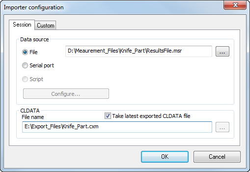

- Click
to display the
Importer Configuration
dialog.
- Choose an import method. Select:
File
to import the point data from the measurement file created by the machine-tool controller. Enter the location and name of the file you want to import in the adjacent box, or click
to select the file.
Serial port to import the point data from the serial port connection of the machine-tool controller. When you first use this option, click
Configure
and specify the serial configuration settings required by the controller. For more information on the serial configuration settings required, refer to your controller's documentation.
Script
to specify a custom import process. For example, this option enables you to specify a custom method for importing data from sources other than files or serial ports.
Note: Before you can select the
Script
option, you must complete the
Script file name box of the
Custom
tab.
- By default,
PowerInspect verifies the imported data against the last
exported CLDATA (.cxm) file. To use a different CLDATA file to verify the data, deselect the
Take latest exported CLDATA file check box, and enter the location and name of the file in the
File name
box.

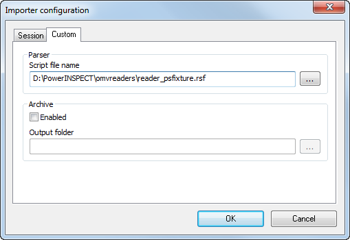

- Select the
Custom tab.
- By default,
PowerInspect uses
reader_psfixture.rsf in the
\omvreaders
folder to import measurement data. If you want to use a different import script:
- Select the
Custom tab.
- Enter the location and name of the script file in the
Script file name box.
- Select the
Script option on the
Session tab.
- If you want to save the measurement data to archive files so you can re-import the data:
- Select the
Custom tab.
- Select the
Enabled
check box.
- Enter the location of the folder in which you want to save the files in the
Output folder box.
The name of each archive file is created by appending the date and time on which the archive file was created to the name of the .pwi file.
- Click
OK to save your changes.

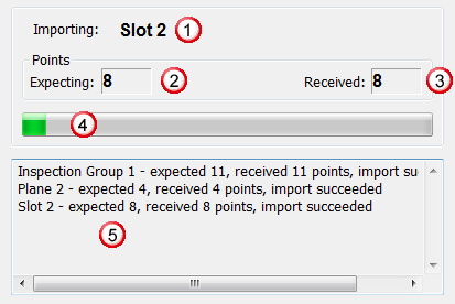

- On the
NC Program tab, click
to import the measurements. The
NC Program tab displays the details of the import as it progresses.
Where:
shows the name of the inspection sequence item being imported.
shows the minimum number of points required to measure the item.
shows the number of points received for the item.
shows the progress for the current item.

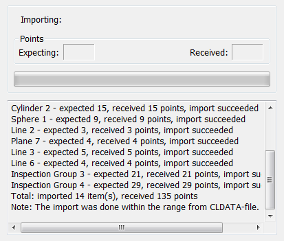

lists the details of the imported items. When the import is complete, a summary is displayed, for example:
