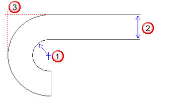

Use hem-edge points to measure a rounded edge on a part.

- Select Hem edge, and enter the Radius of the edge
If you specify a Radius of 0 for the hem edge, PowerInspect saves the group as an edge-point inspection group.
- Enter the thickness of the surface
in the Edge box of the Default offset area. If the surface is to be probed from the top, enter the offset as a positive value. If the surface is to be probed from the bottom, enter the offset as a negative value. The nominal position of the hem edge
is calculated as the sum of the Radius and the Edge values.
