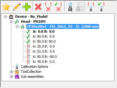

Probe View
The Probe View displays the details of the measuring device to be used when creating inspections for CNC machines and manual CMMs.
Probe View
When the document is connected to the measuring device, the view displays the device's current set-up. When the document is not connected to the measuring device, the view can be configured to use any machine set-up.
The Probe View includes the:
- Probe View toolbar
- Machine Model area (for CNC machines).
- Probe Head area
- Probe Tool area
- Probe Positions area (when using an indexable head)
- Sub-assemblies area (for CNC machines)
When the document is connected to a CMM using the device or I++ Client Tool protocol, it also displays:
- Icons indicating whether the probe and probe position are calibrated
, or uncalibrated
. If
Use form tolerance setting is selected, an additional
icon indicates whether the probe or position is calibrated, but outside the specified form tolerance.
- The last calibration date of the selected probe or position; the effective or nominal diameter of the stylus, and the calibration status of the selected probe or position.
Probe View Toolbar
Specify and calibrate probes for CNC machines or manual CMMs for the document, and calibrate the probe assemblies.
The options depend on whether the document is connected to the measuring device, and the connection protocol.
To sort the probe positions, right-click a probe and choose an option from the context menu. Select:
Reset to clear the selected sort options.
Take calibration into account to list all calibrated orientations followed by all uncalibrated orientations.
A angle first to sort the orientations by the size of their A-angles.
B angle first to sort the orientations by the size of their B-angles.
Ascending order to sort the angles in ascending order of size.
Descending order to sort the angles in descending order of size.
When the document is connected to the measuring device using the I++ Server protocol, the Probe View lists the server's probes. You can select the active probe and probe position using the Probe View toolbar, but you must define and calibrate the probes within the I++Server.
