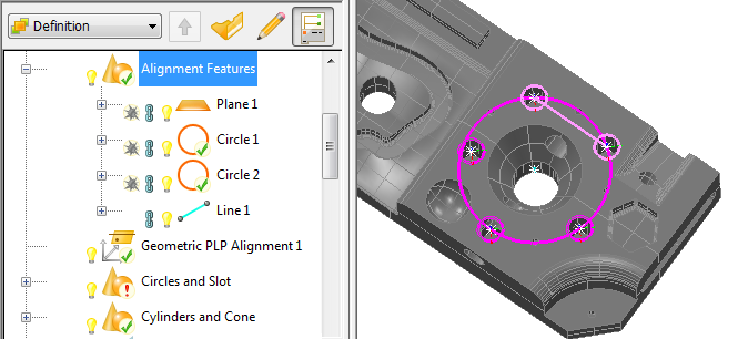

Colours — Control how items shown in the CAD view are displayed when they are selected in the inspection sequence.
General — Set the color of the CAD View background, back faces, selected surfaces, label arrows, and grid lines.
Entities — Specify the colours of the information indicators for items selected in the CAD view or the inspection sequence.
