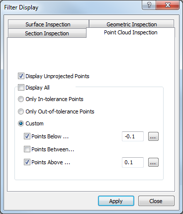

To filter the display of the measured point-cloud points in the CAD view, click View tab > View Options panel > Filter Display and select the Point Cloud Inspection tab.
The tab contains the following settings:
Display unprojected points — Select this check box to display unprojected points
Display all — Select this check box to display all point cloud points.
To limit which points are displayed, deselect the check box and then select:
Only in-tolerance points to display points that are within tolerance.
Only out-of-tolerance points to display points that are out-of-tolerance.
Custom to specify the lower and upper limits of the points to be displayed. Select the Points below check box to display points below the specified lower tolerance limit; select the Points above check box to display points above the specified upper tolerance limit; select the Point between check box to display points between the specified upper and lower tolerance limits.
Click Apply to display your changes in the CAD view.
