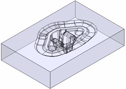

The block defines the stock size. The part is then machined from the block. In this case, the block is a rectangular cuboid.
To define the block:
- Click
to display the
Block dialog.
- In the
Block
dialog, check that:
Defined by is set to
Box.
Coordinate System is set to
Active Workplane.
- In the
Estimate Limits
area,
Expansion
is set to
0 and
Type
to
Model.
Draw
is selected.
- Click
Calculate to define a cuboid enclosing the die. Click
Accept to close the dialog.
Tip: To toggle the display of the block on and off, click View tab > Appearance panel > Block.
