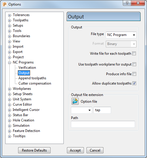

- In the
NC Program dialog, click the
Options
button. The
Options dialog is displayed.
- On the
Output tab:
- If selected, deselect the
Write File for Each Toolpath option. As a result, the
Output File is displayed at the top of the
NC Program dialog instead of the
Root Name.
- Select
Option File as
heid400.
- Enter
Output File Extension as
tap.
- Click
Accept to update and close the
Options
dialog.
- Click the
Accept
button at the bottom of the
NC Program
dialog to create a new roughing NC program.

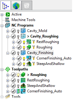

- From the individual NC Program,
Cavity_Roughing, context menu, and select
Edit > Copy NC Program.
- A new entity is added to the
NC Programs list with the default name of
Cavity_Roughing_1. Right-click it and
Rename it as
Cavity_Finishing.
To identify which NC program is currently active, expand the
NC Programs node in the Explorer; the active program is shown in
bold and preceded by the
> symbol.
- In the Explorer, move the two roughing toolpaths under
Cavity_Roughing, and the two finishing toolpaths under
Cavity_Finishing.

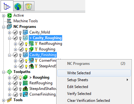

- Select the
Cavity_Roughing and
Cavity_Finishing NC programs. Right-click and select
Write Selected.

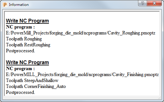

PowerMill postprocesses the NC programs using the specified parameters, and displays a confirmation window showing where the programs are saved.
Two NC programs are written:
Cavity_Roughing.tap containing both roughing toolpaths, and
Cavity_Finishing.tap containing both finishing toolpaths.
- Click
to close the
Information window.
