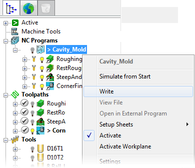

- In the Explorer, right-click the NC program,
Cavity_Mold, and select
Write from the context menu.
