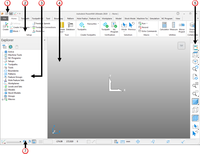

The following window is displayed when you start PowerMill:
The screen is divided into the following main areas:
Quick Access Toolbar — Enables you to quickly access frequently used ribbon commands, such as Save, without having to navigate the ribbon.
Ribbon — A collection of tabs and panels that organise PowerMill functionality.
Explorer
— Provides control over all PowerMill entities.
Graphics window is the working area of the screen.
View toolbar — provides quick access to common views and shading options in PowerMill. The full range of viewing options are available on the View tab
ViewCube enables you to interactively orientate the contents of the graphics window.
Status and Information toolbar enables you to create and activate workplanes, display various preset and user-defined settings. If you hover the cursor over a button, help is displayed. The help can be, for example, a brief description of the item beneath the cursor, or information about the calculation that is in progress.
