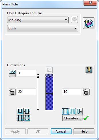

To add solid hole features, with chamfered edges, to the plate:
The Hole dialog is displayed:
0 2.5 0

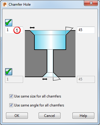

The Chamfer Hole dialog is displayed:
0 -2.5 0

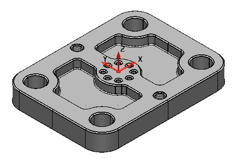

Your model should look like the one shown below:
