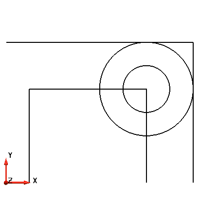

An arc is a wireframe representation of a partial or full circle. In this example, full arcs are used to represent holes in the plate. You can create full arcs by specifying their radius and a center point.
To create arcs to represent holes in the plate:
- Click Wireframe tab > Create panel > Arc > Full.
- Click in the Command Input box on the Status Bar and type the following series of commands. Press the
Enter key between each one:
r 1
Note: Using
r in front of the value indicates that the command is being used to specify the arc radius.
3 2 0
r 0.5
Note: Specifying a new radius causes
PowerShape to create a second arc.
3 2 0
- Click
on the Quick Access toolbar to exit arc creation.
- Click in an empty space in the graphics window to deselect the arc.
Your model should look like the one shown below:
