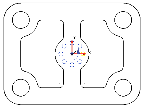

- With the arc selected, click Edit tab > Transform panel > Rotate. The
Rotate toolbar is displayed:
- Click the
Copy the selected items
button.
- Enter
7 in the
Copies text box.
- From the
Angle
drop-down list, click
45.
A preview of the rotation is drawn on the model:

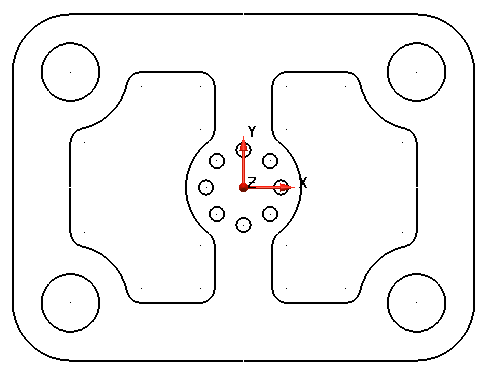

- Click in an empty space in the graphics window to deselect the model.
Your model should look like the one shown below:
