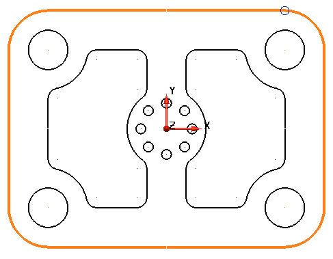

A composite curve is a continuous boundary, which can be made up of various wireframe objects, as well as the edges of surfaces. In this case it is useful to create a continuous curve from the wireframe lines and arcs that form the outline of the plate, so that it is a single, continuous object.
To create a composite curve from the wireframe objects:
The Create Composite Curve toolbar is displayed:
A composite curve is traced around the closed outline of the model:
button.

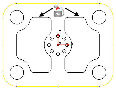

button.You can also create composite curves by holding down the Alt key as you select a continuous section of wireframe. For example:
