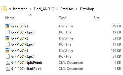

About Single PCF Per Isometric Drawing
A single PCF is created along with the isometric drawing.
Note: Turn on EnablePCFPerDrawing in IsoConfig.xml to enable this functionality.
After you create an isometric drawing, a separate PCF is created along with its matching DWG file in the same folder.
