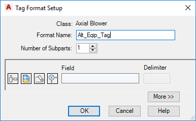

- On the Class Settings pane, under Tag Format, click New.
- In the Tag Format Setup dialog box, do the following:
- In the Format Name box, enter the name of the new format (for example: Alt_Equip_Tag).
- In the Number of Subparts box, enter a number or click the arrows until the desired number of subparts is displayed.
Click the Expression icon (the last icon in the row).

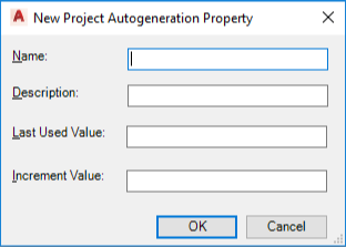

- In the Select Project Autogeneration Property dialog box, click New.
- In the New Project Autogeneration Property dialog box, do the following:
- In the Name box, enter the name for the new property.
- In the Description box, enter a description for the new property.
- In the Last Used Value box, enter the value to use for the last value for the new property.
- In the Increment Value box, enter the increment value for the new property.
