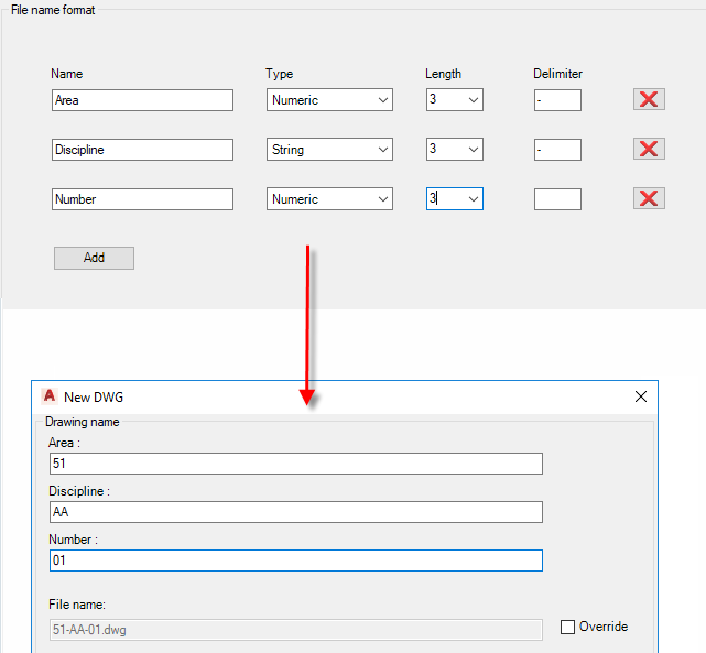

File Name Format (General Settings Tree Node)
Sets up the format for file names, which is reflected in the New DWG dialog box that designers use to create new drawings.
Click Add to start creating a file name format.
File Name Format
Lists the fields that you use to create a file name format for a project.
Name
Sets the name of the field in the New Dwg dialog box.
Type
Specifies the type of entry (for example: string, numeric, and so on).
Length
Sets the maximum length of the entry. This box is available only for string or numeric entries.
Delimiter
Sets the character to be placed between items in the file name (for example: comma or dash).
X
Removes a line of file name fields.
Add
Adds a line of file name fields.
