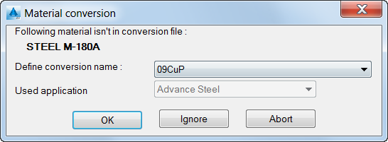

The dialogs for material and section conversion open if the extension cannot automatically assign materials and sections from Robot databases to materials and sections in Advance Steel databases. It results from differences in element names between databases in the source and target applications.
The Material conversion dialog displays for each material that cannot be converted (assigned) automatically. Repeat these steps for each of these materials.

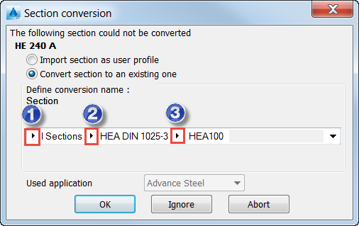

In the Section conversion dialog, perform one the following:
Use it to transfer a section from Robot as a User Section to Advance Steel.
