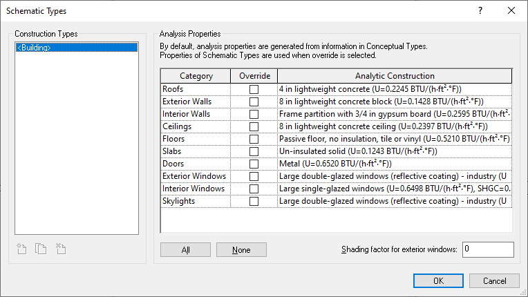

Schematic types define thermal properties for building elements during schematic design.
Subsequent energy analyses then use the corresponding thermal properties, which provide more detailed information than the default conceptual types.
You can select the specific element categories for which you want to use schematic types. Any element categories not overridden with a schematic type will continue to use the default conceptual types. If the Detailed Elements option is enabled, schematic types and conceptual types are overridden by materials-based thermal properties, where defined.
To use thermal properties defined by schematic types
Energy Optimization panel
(Energy Settings).
The Schematic Types dialog displays the list of element categories, with the Override checkbox cleared for all categories.
When you next perform energy analysis, thermal properties for the specified schematic types (analytic constructions) are used for those element categories.
