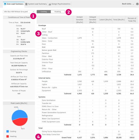

The Zone Load Summary allows you to select a zone to examine in the top left
, as well as toggle between cooling and heating loads
. Within the report a table shows the contribution of load from each categorical subsection
. The grand total shows the total sensible (delayed and instant), total latent, and total load for use in sizing components

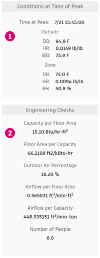

The report includes a subsection that details the environmental conditions during the peak
and a few high-level metrics for QA/QC purposes

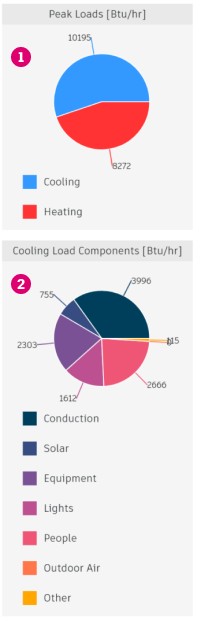

Pie charts provide:
A visual aid to understand the peak load for cooling and heating relative to each other
A total sum of similarly related sources of load

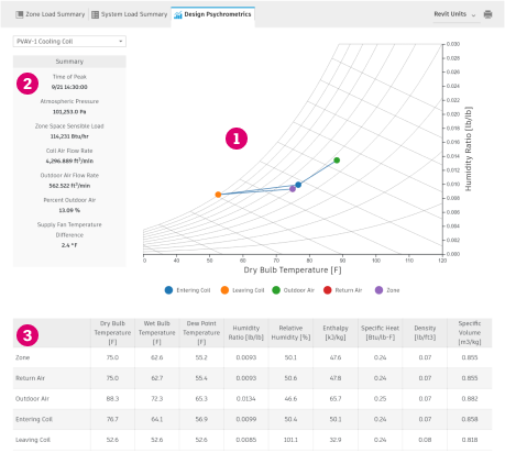

The Design Psychrometrics report shows the psychrometric state points of air for any system that contains a cooling coil. Primarily, this report shows a psychrometric chart to see the state of air at each point of a system
. A summary table highlights various related system properties
. Finally, a table below the chart provides the specific values for psychrometric state points at constant pressure shown in the chart
