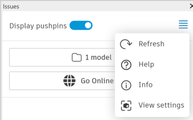

Settings
View settings for the Revit Issues Add-in view can be found in the hamburger menu on the Issues pane.
Within the view settings you can check the current name view used by the Revit Issues Add-in. This is useful if the name of the view has been changed from default.
