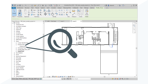

Find in Project Browser
Select elements in your model and use a right-click to locate the element in the Project Browser. With nothing selected, the active view (or sheet) is located in the Project Browser.
The new search method makes it easier to work in models with many views, sheets, and elements. See Project Browser for additional information.
