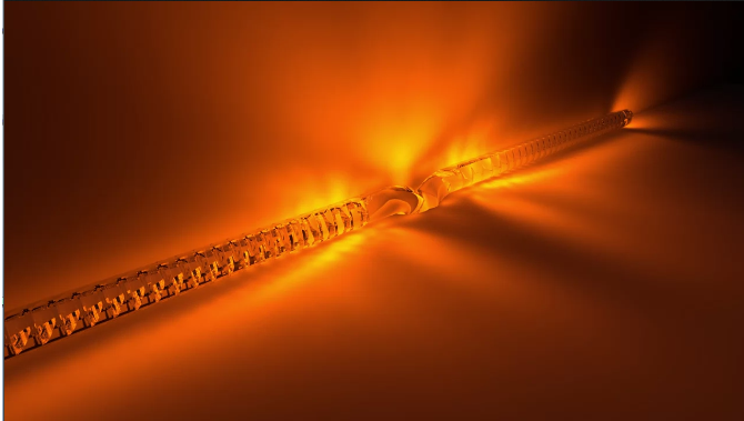

As of 2022.2, partial support for Speos 2.1 and Speos 2.2 format was added to help with reading problematic Ray files. Unsupported data, such as polarizaton, will be ignored.
There are two ways to use ray files for illumination:
Use Photons for Direct Lighting - This (photon mapping) is the easiest to use. The rays in the ray file are traced like photons. The limitation of this approach is that the ray light is not visible in reflections or when looking directly into it.
Evaluate Ray Lights -This needs the surface with the ray origins for the rays stored in the ray file. This surface needs a material applied to it with Evaluate Ray Lights enabled. In the ray file, Use Photons for Direct Lighting must be disabled. The surface now becomes the light source and evaluates the data stored in the ray file when another ray hits the surface. Since a ray is infinitesimally small, it will never hit the origin of another ray stored in the ray file from the direction of the ray file. Therefore, Radius, Cone, and Offset are used to define a region in which to search for rays in the ray file.
Specifies the ray file to use. Use any of these options:
opens a file browser and loads an IES profile from a file.
opens a menu with a list of Ray files in the scene.
removes the currently loaded Ray file.
Ignores the spectrum of the rays and uses only the light spectrum for all rays, instead.
Uses random sampling of the rays. Use when there is more than one luminaire in your scene.
Toggles whether to use photo mapping for direct lighting or not.
If enabled, rays stored in the ray file will just be traced like photons. However, ray lights are not visible in reflections or when looking directly into them.
If disabled, ray lights can be used without photon mapping, but the surface must be defined with Evaluate Ray Lights on. These surfaces will then act as light sources, using all the ray files within the given radius.

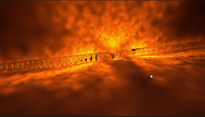

Reduces noise by controlling the size of an emitter cone used to vary the direction of emitted photons from ray lights. This increases the number of photons that can be generated during tracing. You get smoother images, while only sacrificing a bit of accuracy. It also clamps colors outside the color gamut.
| Before Emitter Cone Changes | After Emitter Cone Changes |
Since the quality of Ray files depends on the number of photons stored in the file, you want to create noise-free images. But, these require many photons - often more than what is commonly available in a Ray file. This is where the Emitter Cone options comes in.

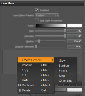

Not all lights will have image processing parameters. Point and Spot will, since lens flares can only be enabled for them.
Use presets or create custom lens flares. Use the Lens Flare parameters for making global changes to all lens flares. Right-click in a blank area to access a context menu.
Lens flare is an effect attached to a light (Point or Spot) and affect image processing. It is available in OpenGL and raytracing render modes and added as a post process. Use the Lens Flare parameters to globally adjust color, size, intensity, radius, and angular intensity. For control of individual Lens flare elements, such as shape and color, use the Custom preset.
Since lens flares can be created only for point and spot lights, select one to access the Image Processing Lens Flare parameters.
Enables or disables the lens flare applied to the selected light.
Contains a list of the following assorted lens flare presets, which can be easily applied to your scene. The selected preset is applied to the selected point or spot light.
It is also possible to start from scratch by selecting Custom to create your own lens flares. Use the other presets' attributes as a base for your custom lens flare. Doing this will not override the preset. Elements can be created for your custom lens flare. See the Ghost Line section of Elements that follows for more information.
Always uses the Intensity of the light settings. This only affects the color and applies to the selected light source's lens flares. When disabled, the color set in the Image Processing tab's Color option is used globally.
Changes the color of all lens flares. The color selected is multiplied with any element color already assigned.
If Use Light Properties is enabled, the color set here is ignored and the light color is used.
Since this color is multiplied with element color assignments, there may be instances where a lens flare disappears, due to the multiply operation. If this occurs, try changing the color of the individual lens flares (instead of using this option) or change the color of this option.
If there are no element assigned colors, this color is assigned to all lens flares.
Changes the size of all lens flares.
Changes the brightness of all lens flares.
Changes how dispersed the flare is for all lens flares. The radius represents the virtual size of the light sources, since the lights do not have geometry. A larger radius requires a larger object to completely occlude the effect. Shrinking of the lens flare will start when the radius around the light source starts to get occluded by an object. That occlusion also decreases the intensity of the ghosts. As the radius increases, the intensity of the light decreases. As the radius decreases, the flare becomes more intense and defined.
Changes the brightness of the flare, as the angle changes. As the light source is rotated toward the viewer, becoming perpendicular to the view, its intensity increases. It is like how intense a sunset gets as it reaches the horizon, just before setting. Another example would be turning a flashlight's beam toward you. From your point of view, as the light aligns with your view, it becomes more intense, to the point of blinding.
Right-click in a blank area to access a context menu, select Create Element, then an element from the list. Once an element is created, options appear for renaming, duplicating, and editing it.
For more information on elements, see About Lens Flares and Elements.
