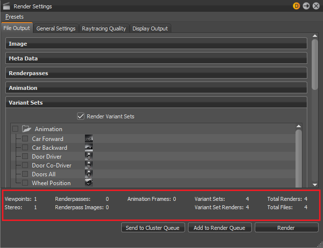

Find the render summary above the Send to Cluster Queue, Add to Render Queue, and Render buttons.

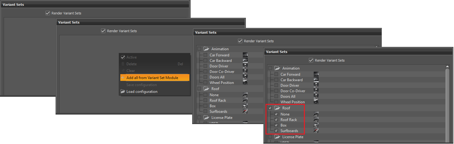

Use the Variant Sets section to easily render multiple versions of a model in VRED. Render a red car in a garage, yellow car in a garage, and red car in park, in one render job. Material and environment variant sets can be set by checking what's wanted and unchecking what's not.
If you reorder groups by click-dragging, this changes the render and naming order of your files. Reordering is not permitted on a per variant set basis, only with groups.
When ungrouped variant sets are dragged from the Variant Sets module to the Variant Sets section of Render Settings, they will be grouped under the same parent node, named ungrouped. This treats all ungrouped nodes as if they belong to one group to simplify deleting, dragging and dropping, and selecting/deselecting.
Render Variant Sets - Enables variant sets to be added to the render job. Right-click to access a context menu with the following options:
Active - Adds checks to all selected variant sets (materials, geometry, and environments) in the Variant Sets section and adds their information to the Render Summary at the bottom of the module.
Delete - Deletes entire folders of variant sets from the Variant Sets section.
Clear - Clears all variant sets from the Variant Sets section and removes all information from the Render Summary below. To add them back, use Add all from Variant Set Module.
Add all from Variant Set Module - Adds all variant sets in the current scene to the Variant Sets section. Check a variant set to render it. To select everything in a folder, check the folder. To deselect everything in a folder, uncheck the folder.
Save configuration - Saves the configurations as an XML file. This is useful to keep along side your VPB files to get the same rendering results another time.
Load configuration - Reloads the XML configuration file for design reviews, so you have the same results as before.
Use View From Variant Sets - Ignores the viewpoint set in the Render Settings module and uses what was set in the view tab of the Variant Sets module.

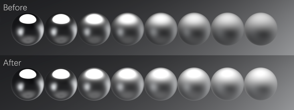

The BRDF shader model better conserves energy. The weighting of the diffuse/glossy/specular layers should consider the glossy/specular colors, in addition to the fresnel reflectivity. The result does not show dark edges when a glossy color turns to black. Instead, it displays a purely diffuse material. This provides better fine-tuning of the specular reflections.
Energy Preserving GGX - Energy Preserving GGX uses a multi-scattering approximation to improve the preservation of a material's energy, especially for high roughness values, creating a realistic material that maintains its properties in any lighting condition. Its improved importance sampling method reduces the chances of fireflies.

The Render Summary is above the Send to Cluster Queue, Add to Render Queue, and Render buttons. Get more contextual information about the render and how long it could take. Get the total number of images and renders.
The same information is also available in the Render Queue, just in a different format.
