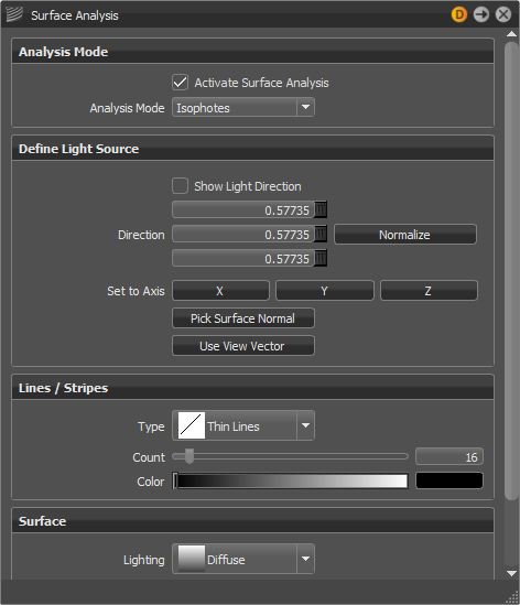

Use the Surface Analysis module to analyze the quality of a surface by examining the continuity of different types of virtual lines, like isophotes, that are displayed on the objects in the scene. Discontinuities on surfaces can be detected. You can use the module for analyzing polygonal as well as NURBS data.
Activate Surface Analysis - Enables/disables the Surface Analysis rendering mode. You can also activate this rendering mode by selecting it in the Visualization Menu.
Analysis Mode - Selects the analysis mode.
Isophotes - With isophotes, it is possible to determine whether a surface is continuous in position, tangency, or curvature. Isophotes are lines which mark spots of same brightness on the surface. The surface is assumed to be perfectly diffuse reflecting. It is lit from both sides by a directional light emitting parallel light beams. You can set the direction of the light source. Isophote lines are view-independent meaning that the lines do not change when moving the camera (except when using the option Use Camera View Vector).

Depending on the chosen Analysis Mode the GUI changes in frame Define Light Source.
Show Light Direction - Shows an arrow in the render view for the picked direction. Use the rotation manipulator to rotate the arrow (does change the direction) and the translation manipulator to move it (does not change the direction).
The translation does not change the direction of the light and therefore has no influence on the isophotes.
Direction - Offers the opportunity to enter values manually.
Normalize - Normalizes the manually entered direction vector to length 1.
Set to Axis - Sets the direction to X (1, 0, 0), Y (0, 1, 0), or Z (0, 0, 1).
Pick Surface Normal - This button enables a tool to select surface normal as light direction. SHIFT + LMB allows you to select a normal of an object. Click the button again to disable the tool.
Use Camera View Vector - To reproduce the Discontinuity Rendering Mode from previous VRED versions select Isophotes as Analysis Mode and enable Use Camera View Vector. This updates the direction depending on the camera orientation.

The following settings allow you to define the visual appearance of the lines on the surfaces.
Type - Defines the style that is used to display the analysis lines on the object surfaces.
Thin Lines - Uses thin sharp lines.
Stripes - Uses stripes that can be modified in their sharpness and thickness.
Zebra - Uses a classical zebra pattern.
Count - Defines the number of lines.
Color - Defines the color of the lines.
These settings allow you to define the visual appearance of the surfaces.
Lighting - Sets the lighting situation for the surfaces. For Isophotes, the defined directional light lights the surfaces. For Highlight/Reflection Lines, a headlight lights the surfaces.
Ambient - The surfaces display single-colored. The Base Color defines the color.
Diffuse - The surfaces are assumed to be diffuse. Set the diffuse reflection color with Base Color.
Phong - The surfaces are lit with the phong lighting model. You can set the diffuse reflection color with Base Color, the glossy reflection color with Glossy Color, and the roughness.
