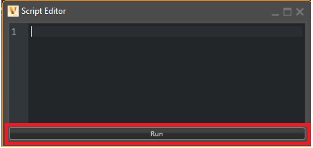

VRED Professional supports custom Python modules (script plugins). Use the Script Editor (Edit > Script Editor) for creating and editing scripts and script plugins and the Terminal (View > Terminal) to view messages and commands. For more information on Python scripts, please check the Python Documentation.
Here's what you can expect from the Script Editor:
Ctrl+F
search functionalityCtrl+G GoTo Line
functionalityUse the Script Editor, found under Edit > Script Editor, for creating and editing scripts.
Use either the main VRED window or Script Editor to run a script.
Use the Terminal window to view errors and warnings, as well as run Python commands.

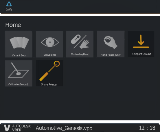

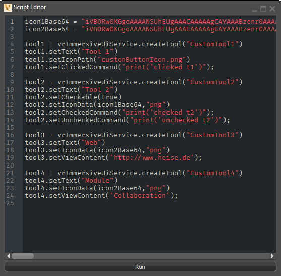

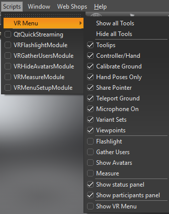

The Scripts menu contains options a list of scripted plugins, along with the xR Home Menu options.
Use the options in the xR Home Menu to customize the tools that appear in the xR Home Menu panel used in VR.
When items in this list are checked, they appear in the xR Home Menu. To remove tools from the menu, uncheck them.
VRED comes with an assortment of scripted plugins, which are listed in the Scripts menu.
