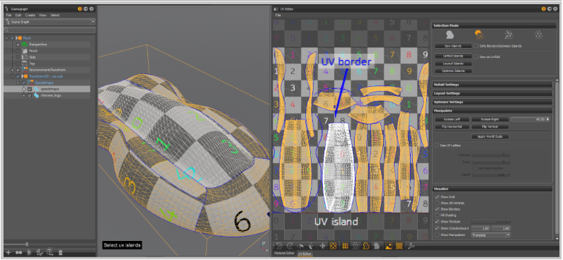

UV Islands and Borders

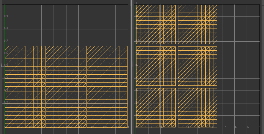

When unfolding a shell geometry for the first time, each of its surface patches will be treated as a separate UV island. Unfold flattens each surface as an island in UV space, and Layout packs the islands next to each other into UV space. If islands should be merged together (treated as one connected entity) in UV space, use Sew Islands, or Unfold Islands with Sew on Unfold enabled.
How this all comes together is when you return to the Material Editor. When the same geometry is selected, under Diffuse Texture, change the Mapping Type to UV.

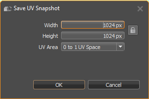

Save UV Snapshot
Exports a snapshot of the UV Layout as an image with alpha channel. When selected, the Save UV Snapshot dialog opens.
Save UV Snapshot
Set the dimensions of the image, choose from 0 to 1 UV Space or Bounding Box for the UV area, then click OK.
To set a preference for this, see Snapshot.

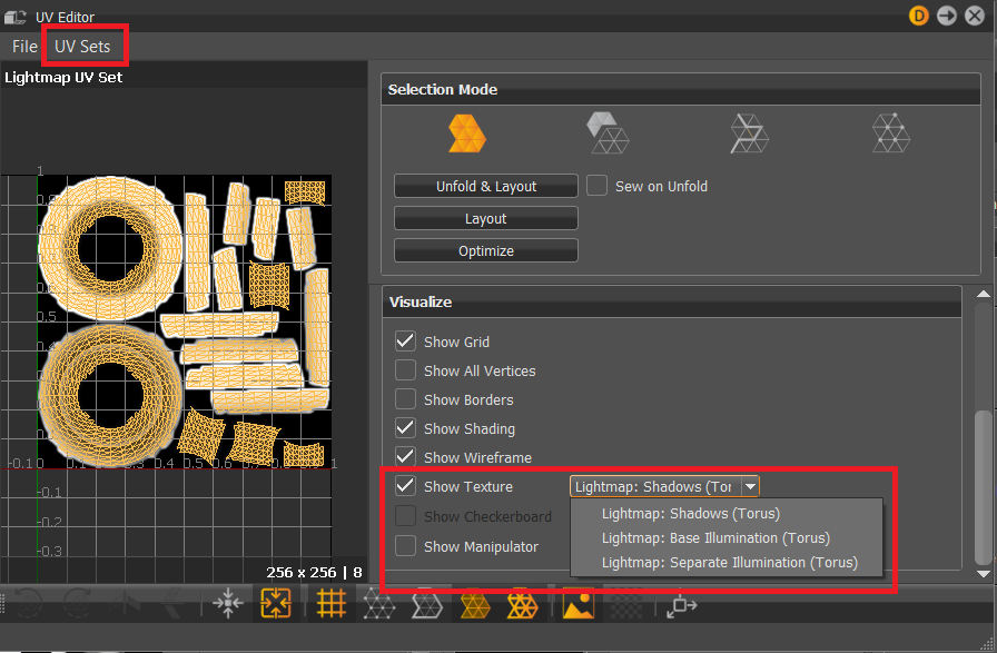

UV Sets
This menu contains options for viewing, copying and pasting, and deleting UV sets, as well as selecting nodes not contained within a UV set.
Material UV Set
Changes the UV Editor viewport to display the material UV sets, since VRED can display lightmap UV sets, as well.
Lightmap UV Set
Changes the UV Editor viewport to display the lightmap UV sets, since VRED can display material UV sets, as well.

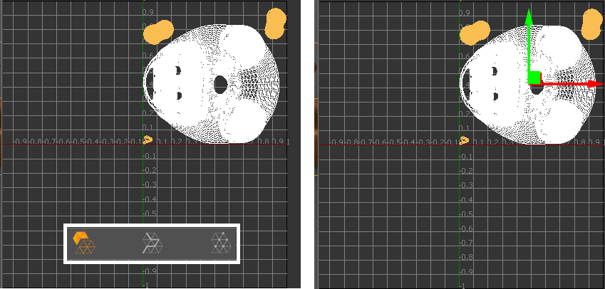

Selection Mode
Sets the selection criteria for the UV Editor (Objects, Islands, Edges, and Vertices) and Render Viewport.
Once a Selection Mode is set, select your content in the Scene Graph to load it into the UV Editor.
Making Selections in the UV Editor
To select islands, edges, or vertices in the UV Editor, first select the geometry in the scene that you want to work with. Then go to a UV selection mode, such as Select UV Islands, and select islands in the UV view.
Note:
These UV islands, edges, and vertices can also be selected in the viewport in 3D rendering. We recommend to enable Wireframe Selection Wireframe Selection to display the current selection. Wireframe Selection can be toggled in the main toolbar.
Wireframe Selection

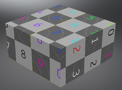

Colors in the UV Editor
Colors play an important role in the UV Editor. They help distinguish one thing from another and whether something is selected or not.
To identify or set the colors for selected or unselected islands, island borders, vertices, edges, and U and V constraints, visit Edit > Preferences > Selection > UV.

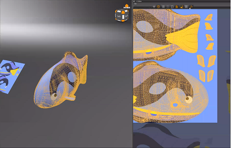

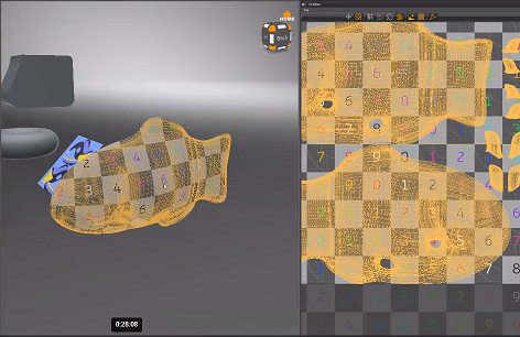

Unfold & Layout
Unfold creates UV coordinates for the selected geometries, with the current Unfold settings. It tries to flatten the surface in UV space. This can only succeed if the surface is not a closed object or has been cut beforehand (see Select UV Edge > Cut Edges). Cuts appear as UV seams in the texture mapping. Afterwards, the UV islands are layed out (see Layout).
Unfold & Layout can be used on geometries without UV. It uses the 3D data of the surface as input.

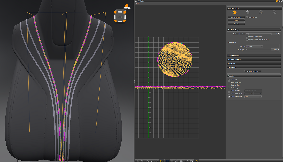

Tip:
If you experience an unexpected unfold result (a circular-shaped UV island), try to deactivate the Prevent Triangle Flips option.
Unexpected unfold result

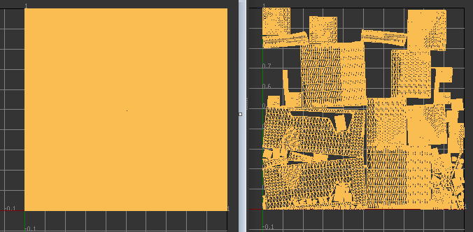

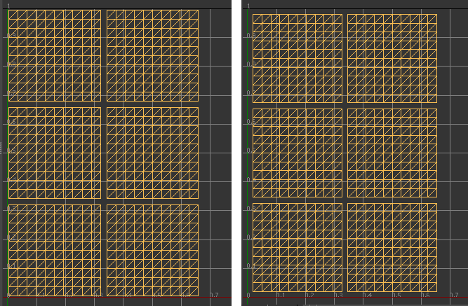

Layout
Before and after Layout
Lays out the selection, based on the Layout Settings established below. It automatically repositions UV islands, so as not to overlap in UV texture space and maximize the spacing and fit between them. This is useful for ensuring that the UV islands occupy their own separate UV texture space.
In general, you should keep UV islands separated for convenience and clarity, but it is not absolutely necessary. For example, you may want the UV islands to overlap so different faces use the same region of a texture.
You can also use the Layout feature to scale or stretch the UV islands to fit within the 0 to 1 coordinates of the UV Editor. This is useful if you need to maximize the texture space used when creating a texture map.
If you perform a Layout and see that the padding isn't correct, either Undo and make the changes or make the changes, then click Layout.

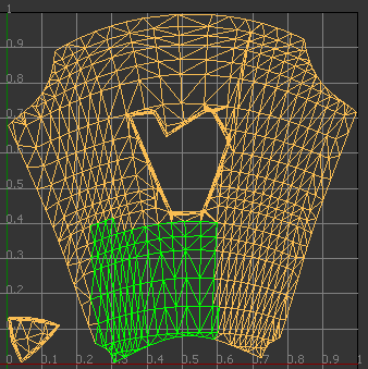

Select UV Islands
Select UV Islands UV islands of selected geometry nodes can be selected. If an island is selected, its corresponding sub-mesh is highlighted white.
Select UV Islands

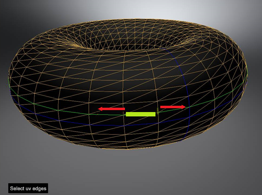

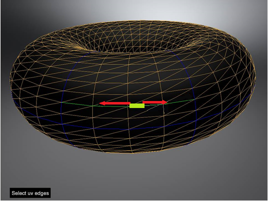

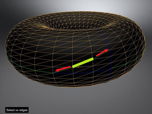

Select UV Edges
Select UV Edges Edges of selected geometry nodes can be selected. Holding the Shift or Shift+Ctrl keys and hovering the cursor over an unselected edge, highlights it the color set in the Selection Preferences. Same can be said for hovering over a selected edge. Selected edges are green by default, but can also be customized.
Only Select Borders
Filters the non-border edges from the new edge selection.

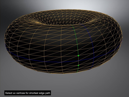

Select Shortest Path
Helps with selecting a path of edges, by clicking, then select at least two points. When picking is complete, the shortest path is created, connecting each way point in the order it was picked and adding it to the current edge selection. See How to Select Edges of Selected Geometry Nodes for more information.
Note:
Select Shortest Path will never cross a border.

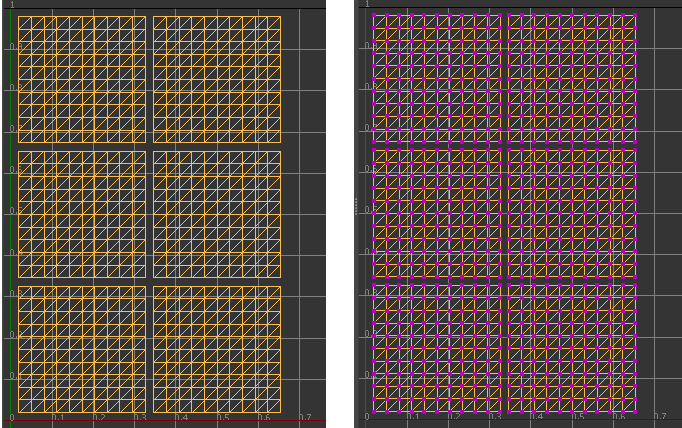

Show All Vertices
Show All Vertices Displays all vertices in the UV map in magenta.

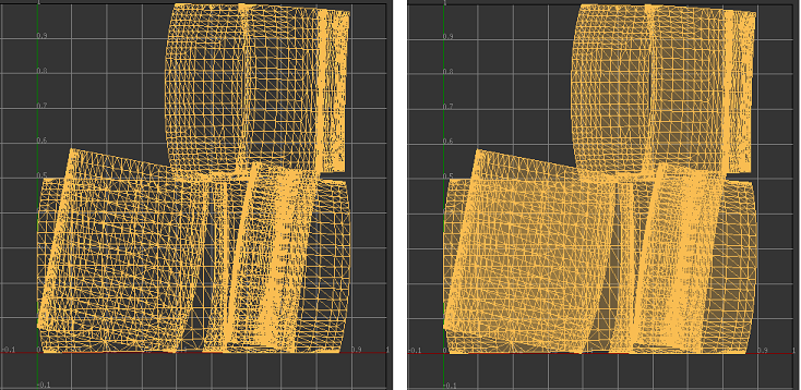

When on (default), prevents degenerate UV maps. Degeneracy can occur when a UV is moved in such a way that a face overlaps itself.
This is an example of how a triangle flip look.
Triangle Flips

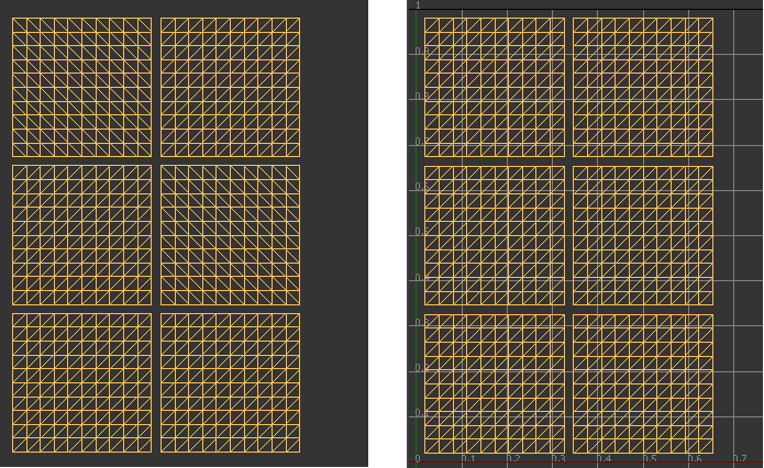

Room Space
Map Size
Select a preset that corresponds to your texture map size (in pixels) for space calculation during unfolding.

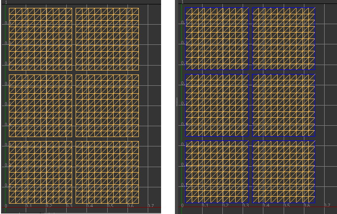

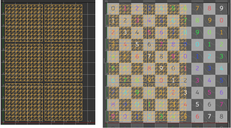

Room Space
Specifies the distance between parts of the selected UV island in pixels.
When Room space is greater than 0, it prevents textures from bleeding past the UV borders. Avoid increasing this value past its default (0 pixels), because it can slow down the unfold calculations and create distortion.
The following example shows the fingers of a hand. When Room space is set to 0, some of the fingers overlap. When Room space is set to 2, the space between the fingers increases.
Note:
Prevent self-border intersections must be turned on to see the effects of the Room Space option.

Island Padding
Determines the amount of space to leave between UV islands when packing. If you do not see an effect, turn on Translate Islands. Add this space to avoid texture bleeding across islands.
In the following example, the image on the left has an Island Padding of 5.00 px. The image on the right has a 20.00 px. Notice the extra spacing between the islands.
Island Padding example
Tile Padding
Determines the amount of space to leave between the UV islands and the edges of the tile.
In the following example, the image on the left has an Tile Padding of 5.00 px. The image on the right has a 20.00 px. Notice the extra spacing (where the red arrows are) between the UV islands and edges of the tile.
Tile Padding example

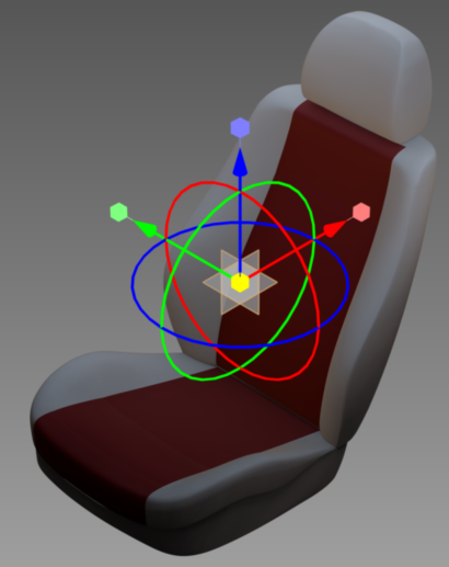

Manipulate
Only available once Project is pressed.
Click this button to display the manipulator in your scene. Click the button to hide it.
To reset the current projection settings for the selected object, click Reset Manipulator. Use this to avoid manually refreshing every value when exiting and re-projecting UVs.
This is an example of the triplanar texture manipulator, which appears in the scene, when the Triplanar mode is selected and Project is clicked.
Triplanar texture manipulator
For additional information, see Using Texture Manipulators.

Show Grid
Show Grid Displays the grid in the UV Editor view.
In the following example, the image on the left only displays UV islands. The image on the right displays them with the grid added.
Show Grid example
Show All Vertices
Show All Vertices Displays all vertices in the UV map in the editor view in magenta.
In the following example, the image on the left only displays UV islands. The image on the right displays them with blue borders surrounding them.
Show All Vertices example
Show Borders
Show Borders Displays borders on UV islands.
Show Borders example

Show Texture
Show Texture Displays the selected textures used by the materials of the selected nodes in the Render Window and UV Editor view.
Show Texture
Note:
If the selected texture has Use Texture Size enabled, the grid uses 0-100 mm labels on the U and V axes, instead of 0.0 to 1.0 labels. This is to help with the world scale texture workflow.
As of version 2022.1, use Show Texture in conjunction with UV Sets > Lightmap UV Set to preview the chosen lightmap texture.
Show Texture options
  1. In the UV Sets menu, select Lightmap UV Set.
  2. In the Visualization section, enable Show Textures.
  3. Choose from the dropdown menu which lightmap texture is displayed:
    • Lightmap: Shadows
    • Lightmap: Base Illumination
    • Lightmap: Separate Illumination
Show Checkerboard
Only available when Show Texture is enabled.
Show Checkerboard Overwrites the existing object material in the Render Window and UV Editor view with Checkerboard. You can input values for the height and width of the checker pattern (to the right of the option). The colors and detail of the checkerboard make it easier to identify distortions, map direction, check details, and display repeats. Select Show Texture to return to the original material.
Checkerboard example
In the following example, the image on the left only displays UV islands. The image on the right displays them with the checkerboard material.
Show Checkerboard example
Show Checkerboard example in the Render Window
Show Manipulator
Show Manipulator Displays the selected manipulator in the Render Window and UV Editor view: Translate, Rotate, Scale, Rotate Pivot, or Scale Pivot.
Important:
The manipulator only works when Select UV Island, Select UV Edge, or Select UV Vertex is active. If one of these is selected, the manipulator is not displayed, even if Show Manipulator is selected.
Show Manipulator example
