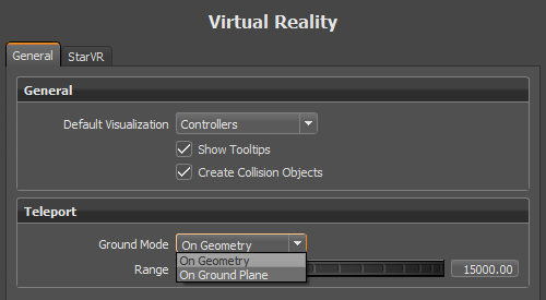

Use the Teleport Ground option in the Tools Menu to set whether you teleport onto the ground plane or geometry. When you want to jump into the driver's seat or walk around the scene, ensure On Ground Plane is enabled. Enable On Geometry to teleport onto the sunroof of a car and look inside.
To set the teleport ground mode, either onto the ground plane or geometry, when a scene is first opened and your teleporting range, see Virtual Reality Preferences.

Use the Teleport Ground option to set whether you can teleport onto geometry or into and around it.
