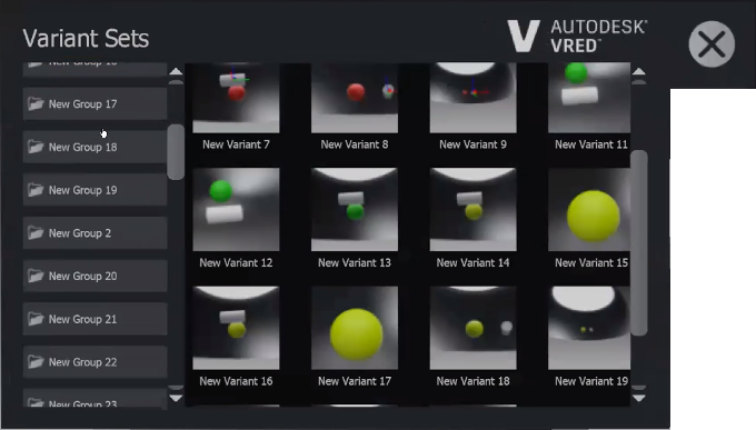

Variant Sets Variant Sets
Opens the Variant Sets (VSets) panel to access all variant sets created for the scene. Any variant sets set in a scene are automatically loaded into the Variant Sets panel of the xR Home Menu.

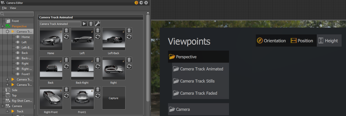

Viewpoint Viewpoints
Opens the Viewpoints panel to access all viewpoints, cameras, and camera tracks created for the scene. For camera and camera track labelling, when there is only one camera, the camera track name is displayed; however, if there are more, they are labelled as the camera name: camera track name.
Cameras and Camera Tracks displayed in the Viewpoints section of the Stream App UI
Any viewpoints set in a scene are automatically loaded into the Viewpoints panel of the xR Home Menu. However; cameras and camera tracks are not updated in realtime. For the app to detect these changes, you must use Ctrl + R.

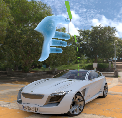

Hand Poses Only Hand Poses Only
Toggles between using the pointer or hand gestures for communication. When enabled, you can point, give a thumbs up or down, make a fist, punch, or open your hand. It also disables all tools mapped to these button, with the exception of the xR Home Menu button. Use hand poses to interact with touch sensors and communicate with others, while in a session.

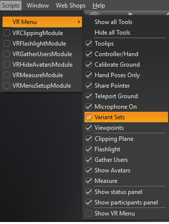

How to Hide Options in the xR Home Menu
If there are options you do or don't want displayed in the xR Home Menu, use Scripts > xR Home Menu to toggle them on or off.
In the menu bar, select Scripts > xR Home Menu, then either check an option to display it or uncheck it to hide it.

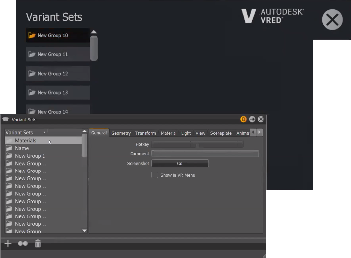

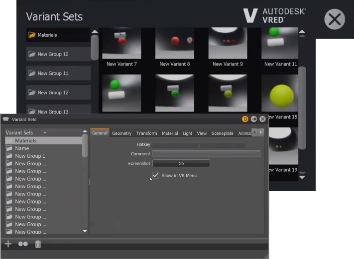

How to Remove Variant Sets from the xR Home Menu
There are two ways to do this:
To turn off the display of Variant Sets in the xR Home Menu from the desktop, select Scripts > xR Home Menu > Variant Sets, then remove the check next to it.
To remove Variant Sets from the xR Home Menu while in VR, so they cannot be seen in VR, use the Variant Sets module.
  1. In the Variant Sets module, select the Variant Set groups to be removed from the left side.
  2. In the General tab, uncheck Show in xR Home Menu. This removes all the selected Variant Sets from the xR Home Menu.
    Removed from the xR Home Menu
How to Display Hidden Variant Sets
To display hidden variant sets groups in the xR Home Menu, select the variant sets group along the left of the xR Home Menu, then in the Variant Sets module General tab, check Show in xR Home Menu.

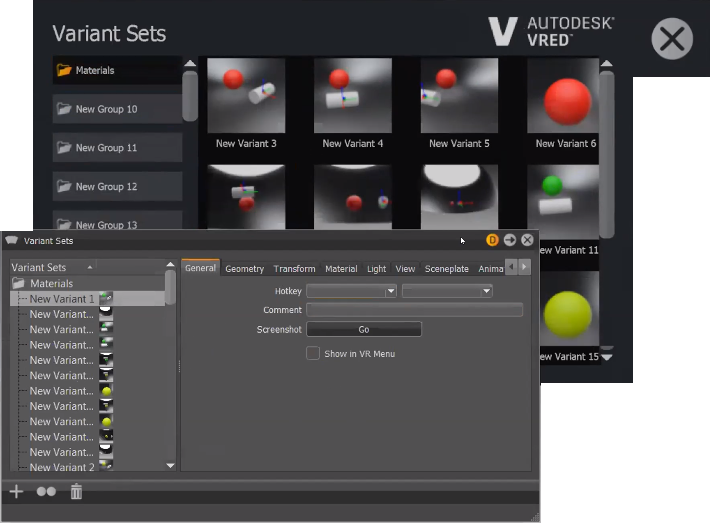

How to Remove and Display Single Variant Sets
To remove single variant sets from a group, in the Variant Sets module, select the individual variant set, then uncheck Show in xR Home Menu.
Remove one Variant Set
To display a hidden variant set, select it, then in the General tab, check Show in xR Home Menu.

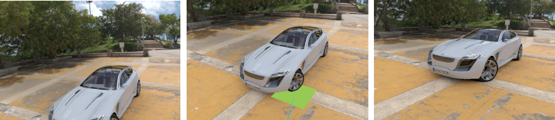

Setting a Floor Detection Mode
VRED supports these two floor detection modes for teleporting:
Click Teleport Ground to toggle between these modes.
