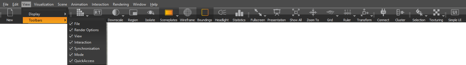

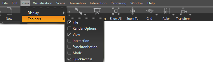

How to Show or Hide Toolbars
Select which toolbars are visible in the main VRED window. Show or hide tools.
In the Menu Bar, select View > Toolbars, then select one or more options.

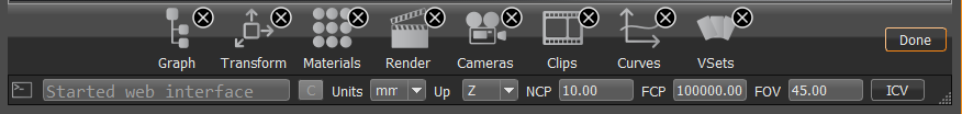

How to Delete a Tool from the Quick Access Bar
  1. Double-click and hold a tool in the Quick Access bar, to access the Delete icon.
  2. To delete a tool, click the Delete icon belonging to that tool.
  3. When finished, tap Done.
    Delete Quick Access toolbar tools

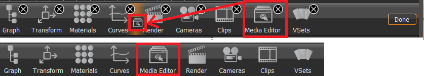

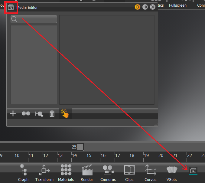

How to Add Tools to the Quick Access Bar
If you are looking for a toolbar with Assets, Scene, Animation, Variants, and Render in it, click Simple UI (the Simple UI mode) to change it. See Switching Interfaces.
Adding button to Quick Access toolbar
Icon added to Quick Access toolbar
Click-hold the icon at the top left corner of any module and drag it onto the Quick Access Bar. This adds it to the far right of the bar.

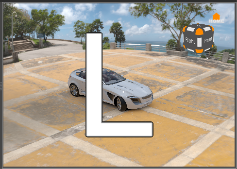

How to Identify Stereo Output Channels
In the Menu Bar, select View > Stereo Identification. A letter appears in the Viewport.

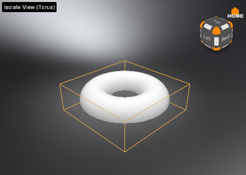

How to Show or Hide Selected Content
To show or hide everything that is currently selected, in the Menu Bar, select Visualization > Isolate View Selected. This adds an Isolate View (name of the selected node) label to the Viewport. Visibility of environments and backplates is not affected. In previous versions of VRED, this feature was available by dragging a node from the Scene Graph into the Viewport.
Show Simulation Isolate
