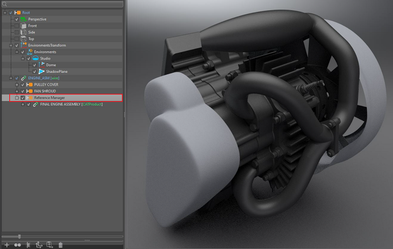

For VRED 2022 and beyond, import native CAD files assembled in the Alias Reference Manager into VRED 2022. A new Reference Manager group will be created in the Scene Graph to mimic the Alias Reference Manager and layers.
Alias 2021 introduced the possibility to create an assembly structure from various CAD file formats, such as .wire, .iges, .step, etc. Alias creates an intermediate .wref reference file for modeling and visualization purposes in the viewport, while keeping the link to the original CAD file in the background. When importing an Alias .wire file containing an assembly structure into VRED, the linked CAD files are now imported, as well. Find these imported assembled files under the new Reference Manager group in the Scene Graph.

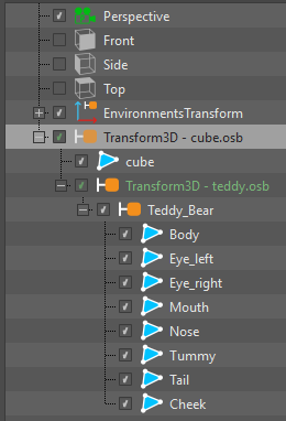

    Add File Tree View
    All objects of an added file are grouped in a group node. Imported files are marked green in the Scene Graph.
    Add File Group Child Tree View
