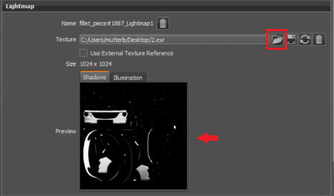

Saves all lightmaps used either to the scene file or an external location (if Save Texture As External Reference is enabled).
Repath Lightmaps
Opens a set folder and looks for file names matching the lightmap names. If a file cannot be found, the Repath dialog appears for locating the file.

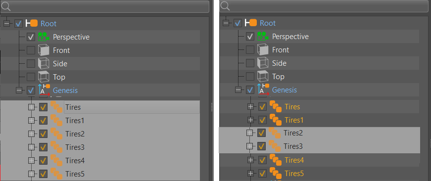

Select Nodes With Missing Bake
Selects all nodes of the selected bake type missing a bake, as well as unbaked nodes with Active Bake set to None. Use this to save time by only performing calculations on these nodes, instead of including nodes with a bake. Hidden nodes are not respected.
Tip:
The Calculate Missing button selects the same content; however, doesn't display it in the viewport.

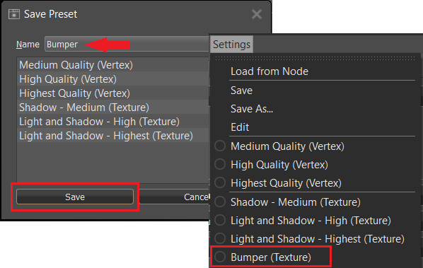

Save As
Creates a new preset, once changes are made to an existing one. The new preset appears at the bottom of the preset list with (Vertex) or (Texture) appended to its name. For example, if the current bake type is set to Texture and the preset is named, Bumper, it will appear as Bumper (Texture) in the Settings and Save Preset lists.
Save Preset dialog

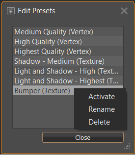

Edit
Opens the Edit Presets dialog for activating, renaming, or deleting a preset. Right-click for these options. Activating a preset applies the bake light and shadows settings of that preset to the selected nodes.
Edit Presets

Changing the Select option or manually selecting something else, changes the content listed in this section.
Name
Displays the name of the selected node. If multiple are selected, the name is highlighted in yellow, indicating the name differs among the selected nodes.
Multiple things are selected

Lightmap
Only available for nodes where texture bake calculations were performed.
Lightmap preview
This section displays the shadow and illumination maps for the geometry selected in the viewport.
Note:
The Properties section cannot display multiple lightmaps. Therefore, you must select one thing at a time to preview the textures. To select another image file, click the Open icon Open icon, select another image, then Open. The new texture is loaded into the Lightmap section. Be aware that the UV layout must be identical to the new loaded texture and Lightmap UV set to achieve the correct results.
Tip:
If you are expecting to see a lightmap and there is none, ensure the texture and/or vertex bake have a Valid state in properties and that Active Bake is not set to None.
Name
Provides an auto-generated name for the lightmap of the selected node. Notice that the name is a combination of the node name followed by _Lightmap and followed by _ numeration, if several lightmaps were baked on nodes with the same name. This name is used when saving the lightmap as an external reference.
