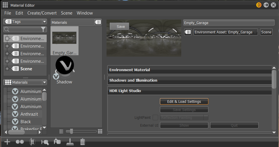

In the Material Editor, select an environment material, then in the HDR Light Studio attributes section, click Edit & Load Settings.
Enable the Area Light option to create a light node in HDR Light Studio, that will promote this light to an area light. VRED automatically creates a rectangular area light, then receives a texture, transformation, enabled state, and primary visibility for the area light.
In the Scene Graph, the light becomes part of the Environment node of the environment material connected to HDRLS. All area lights belonging to this environment are added to a group (both in Scene Graph and Light Editor).
When switching the HDRLS Area Light option on/off, the light node is re-created in VRED.
