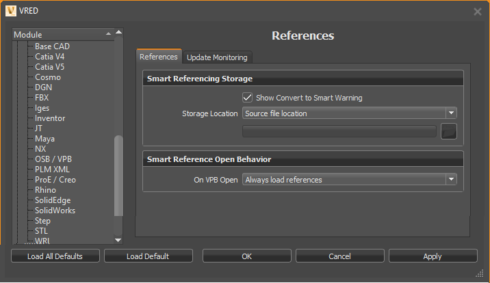

References Preferences
In the Menu Bar, click Edit > Preferences, then on the left side of the dialog box, select References.
Reference Editor monitoring
References Tab
Find Smart Referencing Storage and Smart Reference Open Behavior options in this tab.
This section contains the following options:
Show Convert to Smart Warning
Toggles the warning when VRED is converting a smart reference on or off. When off, there is no warning.
Storage Location
Provides the storage location for converted smart references.
Determines the load behavior of smart references when a VPB file is opened.
On VPB Open
Whenever a VPB file is opened, select the smart reference load behavior:

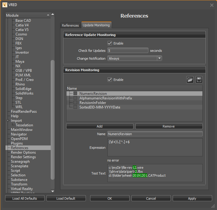

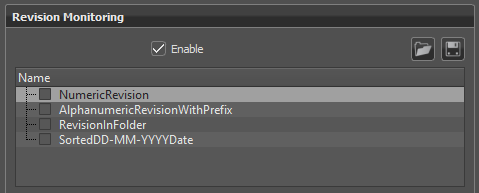

Revision Monitoring
Revision Monitoring Video Captions: In VRED 2020.3, we have implemented a revision monitoring system into the Reference Editor. This can be enabled in the Preferences, under References. Here, you can import example expressions. In my case, I need the AlphanumericRevisionWithPrefix and customize with _rev. See all characters that can be used for creating an expression by hovering over the expression field. After I set my revision rule, I can immediately see which file is out-of-date. The new option to use filters is very helpful to find the parts. Now, right-click the part and select Replace Source > By Revision. Here you can select the revision you want to load and VRED will import the new part. When reimporting, you can select which attributes to preserve, like materials, transformations, animations, touch sensors, or render layers. This method makes it much easier to keep your scene file up-to-date. Thanks for watching the video.
Use the Revision Monitoring preferences to customize the structure used for numeric, alphanumeric, and date revision number, as well as folder names.
Enable
Toggles Revision Monitoring on or off. Enable to access XML revision configurations.
Importing an XML Revision Configuration File
Imports a revisional monitoring entry file for customizing the structure used for numeric, alphanumeric, and date revision number, as well as folder names.
Click Import Configuration, locate an XML revision configuration file, then Open.
Saving an XML Revision Configuration File
Save customization to numeric, alphanumeric, or date revision number, or folder names to a revisional monitoring entry XML file.
After making changes to the expression, click Save Configuration, then Save.
Name
Check Enable to access the Name revision monitoring options. Check an option to customize the expression used for it. Click the following buttons:
Changing Revisional Structure
Use these regex examples for changing the numeric, alphanumeric, and date revision numbers, as well as folder name structure used for revision monitoring.
  1. Select Edit > Preferences > References, then tap the Update Monitoring tab.
  2. In the Revision Monitoring section, check Enable, then check the revisional monitoring option you wish to change from the Name list.
    Name List
    Choose from the following:

  3. Make any changes in the Expression field. Invalid entries are highlighted.
    Expression
  4. Test the text by entering the test file name.
    Test Text
    • Highlights help with writing regexs.
    • There is no highlighting when valid regex syntax doesn't pick up matches in Test Text.
