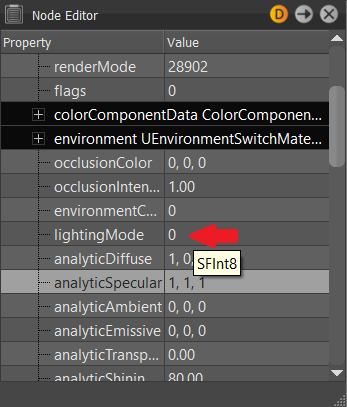

Since there are an assortment of value types, you need to know the value type for a property. Use the Node Editor to get this. Drag a material from the Material Editor into the Node Editor, then hover over the value (right column) for a specific property (left column). The value's tooltip provides the value type for the property.
Node Editor displaying tooltip with the value type
For example, in the image, SFInt8 is the value type. To change the lightMode property of the fur, you would use fur.fields().setInt8("lightMode", 1).
