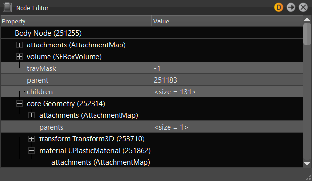

The Node Editor provides information about any node in a scene. You can view detailed information about selected nodes, change values, and attach custom attributes to nodes.
Node Editor
For example, use the Node Editor to set up the ranges for a DistanceLOD. Which child should be drawn for which distance range, set the parameters of the range property, and so on.

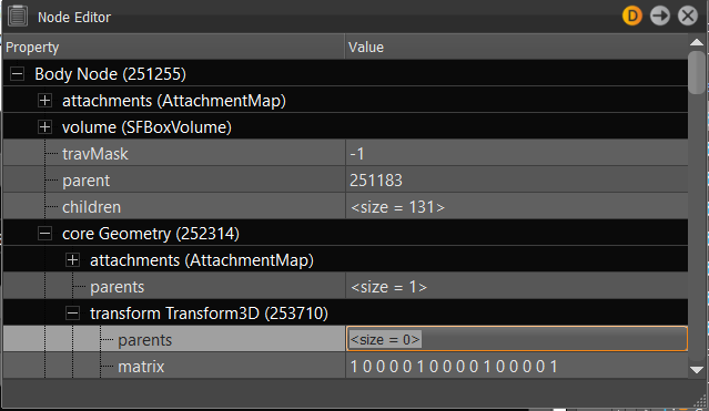

Editing in the Node Editor
With the Node Editor open, click the field to the right of an option, then enter another value.
