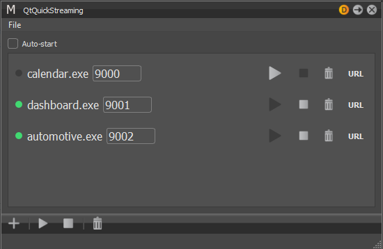

The new script plugin (Scripts > QtQuickStreaming) creates a convenient UI for starting and stopping Qt Quick applications with WebGL streaming enabled.
Qt Quick applcations will run in the background and as child processes of VRED on the local machine.

Use the tools in the Icons Bar for the following:
Add - Adds a Qt application executable to the list. See step 2 of Playing Streamed Qt Content.
Start all processes - Starts steaming all processes in the QtQuickStreaming dialog.
Stops all processes - Stops steaming all processes in the QtQuickStreaming dialog.
When VRED terminates, all processes are stopped automatically. Only in cases where VRED crashes without a crash report, will the started processes continue to run. Look for these process in the Task Manager.
Deletes all processes - Deletes all processes in the QtQuickStreaming dialog.
This section of the QtQuickStreaming dialog lists the Qt Quick application executable names, along with the ports used for WebGL streaming. The port number can be changes only when the process is not running (i.e., before it has been started).
These buttons are found next to every executable:
Start - Starts a Qt process.
Stop - Stop a Qt process.
Delete -
Stops and deletes a Qt process.
URL - Copies the web URL of the streaming web server to the clipboard. Use this URL for a WebEngine. See step 4 in Playing Streamed Qt Content.

This check box is found just below the File menu. By default it is off.
If Auto-start is off, the executable will not start.
If Auto-start is on, the Qt quick processes starts automatically.
Only processes running when you saved the config file will automatically start running.
If the executable has not yet started, press the Play button to start it.

Select Scripts > QtQuickStreaming to open the QtQuickStreaming dialog.
Click +, locate and select a Qt executable, then click Open. This opens the executable in the background.
In the QtQuickStreaming dialog, the Qt application is displayed, along with the port it is streaming to.
