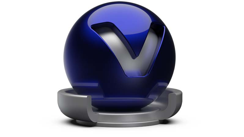

A metallic car paint material has small particles made of metal, or flakes, on top of its lacquer layer. These particles increase the brightness within the angle of incidence, causing a light textured look. The color and size of the flakes is customizable.
The basic structure of this kind of paint consists of a mix of three or four different layers.
The base layer is a solid diffuse colored layer at the bottom to give a constant colored basis, independent from the actual material it is applied to. Usually, grey is used for this layer.
The second layer is the Primary Flake Layer. It contains both colored diffuse pigment particles that give the basic color impression and randomly distributed flakes.
The third layer is the Secondary Flake Layer. Its attributes are identical to the attributes of the Primary Flake Layer.
The last layer is the Clearcoat Layer, which is a specular layer. It can also have colored pigments in it.
