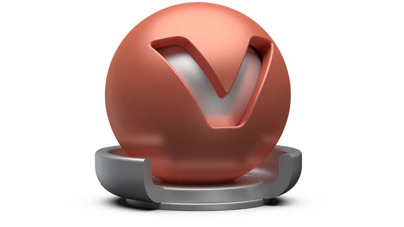

Phong reflection model is an historical technique that describes the way a surface reflects light. It generates diffuse reflections from rough surfaces and glossy reflections from shiny surfaces - based on the fact that shiny surfaces have small intense glossy highlights, while dull surfaces have large highlights that fall off more gradually.
