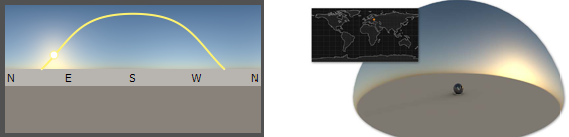

A skylight environment provides physical correct simulated lighting depending on world time and location. Skylights are procedurally generated Sphere Environment materials.
The Skylight provides an interactive preview image that allows you to quickly change the sun position. The yellow curve within the preview image depicts the sun path from sunrise to sunset at the currently set date and location. You can set the sun position represented by a circle by clicking the sun path. The preview image includes labels of the four cardinal directions (N = North, E = East, S = South, W = West). If the current location is on the northern hemisphere, South is the centered direction; for locations in the southern hemisphere, North is the centered direction.
