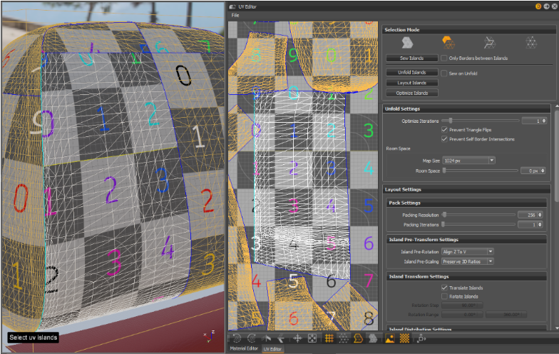

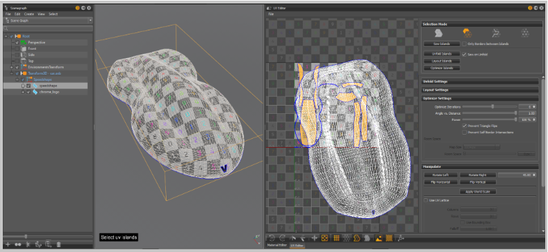

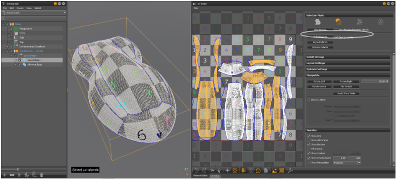

How to Select Islands of Selected Geometry Nodes
Tip:
To select all islands, in the UV view use Ctrl+A.

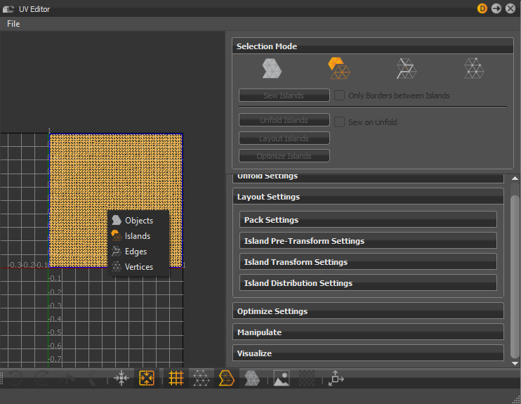

  1. In the UV Editor, Shift+middle-click in the view, then choose Islands from the context menu to set the Selection Mode.
    Selection Mode context menu
    Tip:
    Another way to do this is to click Islands with Normals on (the Select UV Islands icon).
    (A UV island is a sub-part of the mesh where every vertex is directly or indirectly connected to every other vertex in the same island.)

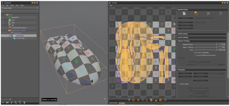

  2. Use the standard VRED object selection methods to select islands. See Selecting Objects in the Viewport.
    Tip:
    When using rectangle selection in the viewport to select islands, you can select either islands on the front-most surfaces or any islands, including ones that are behind another surface. Switch Edit > Selection > Use Depth Selection off to select only islands on the front-most surfaces.
    If you want to work with UV islands on a shell node shell node, select the shell node, not its individual surface components. When selecting the shell node, the UV Editor knows which surfaces of the shell are neighbored to enable sewing of islands on neighbored surfaces.
    Note:
    Two surfaces are detected as neighbors, if their triangles are lining up perfectly where the surfaces meet.
    You can also select individual surface nodes of a shell and work with these in the UV Editor; however, the UV Editor will treat those surface nodes independently and will not consider which surfaces are neighbored.

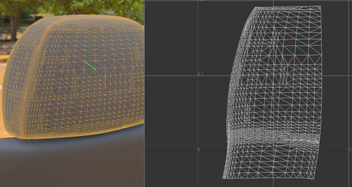

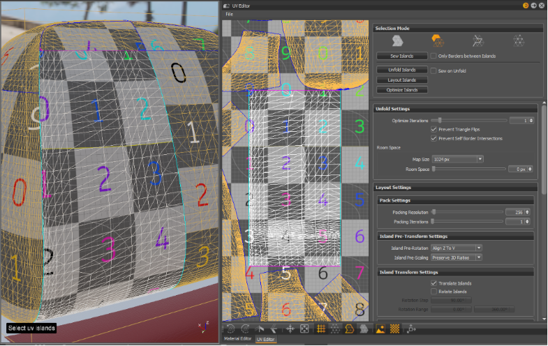

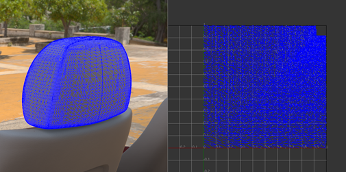

    When you select an island, its corresponding sub-mesh is highlighted white in the UV Editor.
    The UV islands are drawn in the Render Window, if Wireframe (Wireframe) is enabled in the Icons Bar. This adds a wireframe overlay over the solid shading of the selected nodes. The colors are configurable in Edit > Preferences > Selection. White is the default color for selected islands.
    Select Island

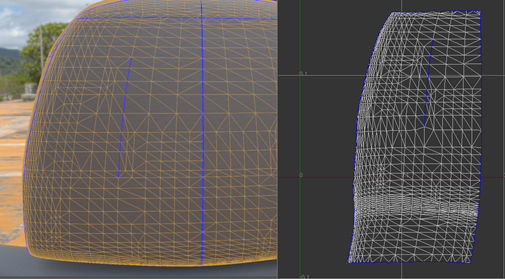

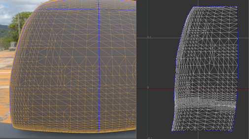

    To see the borders, in the UV Editor, under Visualize, select Show Borders.
    Show Borders

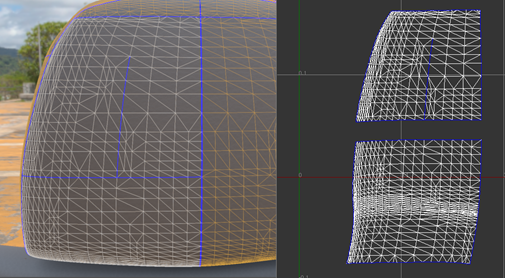

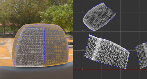

In this example, we manually select islands that should be sewn, and use Unfold Islands, with Sew on Unfold checked.
Shape
Sewn together
The selected islands were sewn into a single big island and this island was unfolded.
Further optimize the UVs (in this case to smooth out the small bump seen below) and layout the resulting island.
Smooth bumps
Smoothing bumps part 2

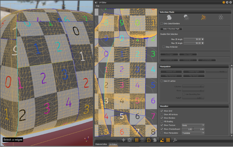

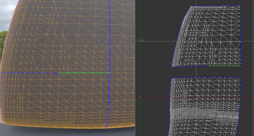

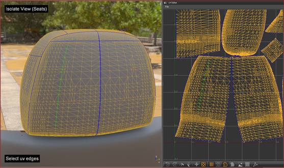

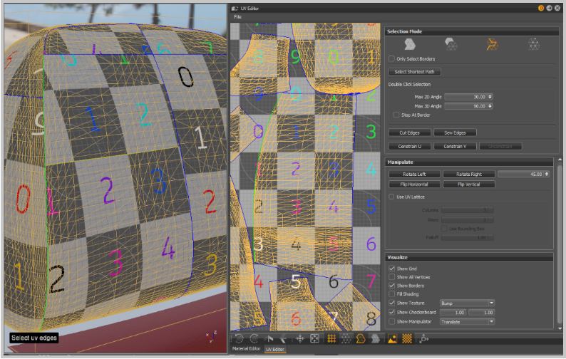

  1. In the UV Editor, Shift+middle-click the view and choose Select UV Edges as the Selection Mode.
    Tip:
    Another way to activate edge selection is to select Edges Normals on from Selection Mode.
  2. Use the standard VRED object selection methods to select the edges. See Selecting Objects in the Viewport.
    Tip:
    To select only those edges on the front-most surfaces, or alternatively to select all edges in the selection frame, whether they are behind another surface or not, in the Menu Bar, toggle Edit > Selection > Use Depth Selection either on or off.

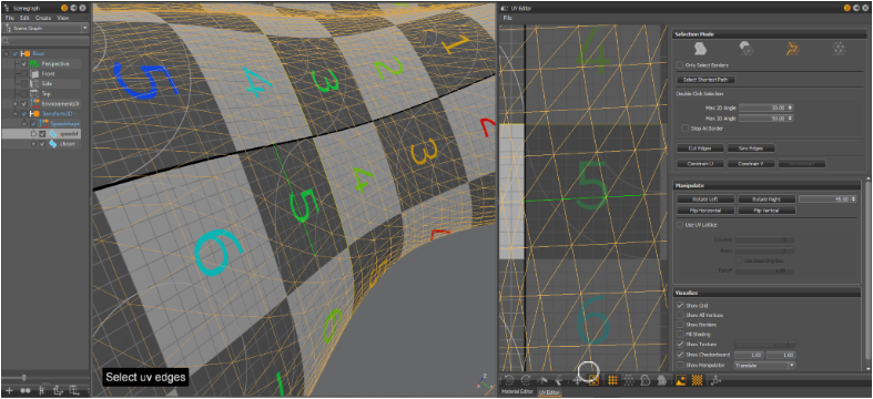

    In the UV Editor, holding the Shift or Shift+Ctrl keys and hovering the cursor over an unselected edge, highlights it the color set in the Selection Preferences. Same can be said for hovering over a selected edge. Selected edges are green by default, but can also be customized.
    The UV edges are drawn in the Render Window, if Wireframe Normals on (Wireframe) is enabled in the Toolbar.
    Select Edges

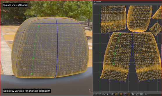

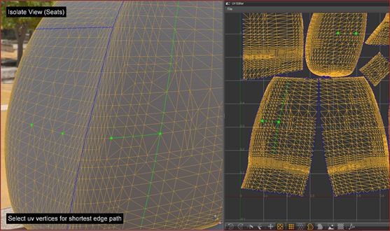

To select a chain of edges:
  2. Select Shortest Path.
  3. Define the edge selection path by picking at least two points.

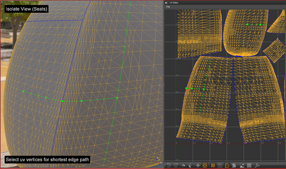

    The shortest path connecting each way point, in the order it was picked, is selected and added to the current edge selection.
  4. To exit Select Shortest Path mode, click the Select Shortest Path button again to toggle it off.

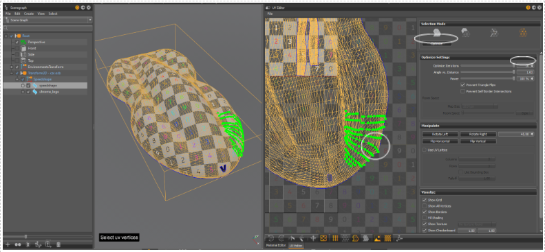

  3. In Selection Mode, check Show All Vertices Show All Vertices to display all vertices in magenta in the UV Editor.
    The vertices are drawn in the Render Window, if Wireframe (Wireframe) is enabled in the Icons Bar.
  4. Hold the Shift or Shift+Ctrl keys and hover the cursor over a vertex to highlight it the color set in the Selection Preferences. Selected vertices are green by default, but can also be customized.”
    Select Vertex

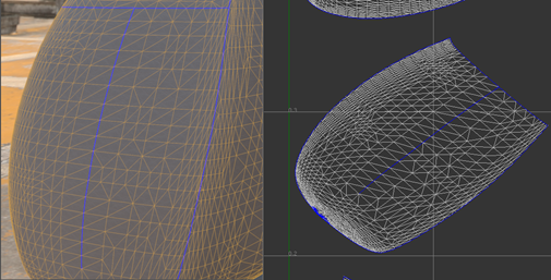

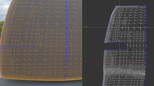

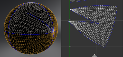

How to Cut and Sew Edges of a UV Mesh
Cut Edges
Cuts are important to the unfolding process. They allow the UV textures to unfold with as little distortion as possible. When unfolded, the UV mesh should lay flat without overlapping.
  1. In the UV Editor, select Edge Normals On (Select Edges) and select two or more edges.
    Tip:
    To highlight the borders, in the Visualize section, check Show Borders.
  2. In the Selection Mode section, click Cut Edges.
    The mesh is cut along the selected edges.
    Cut along edge
    The edges become new borders after the cut.
    Note:
    Cutting border edges has no effect.

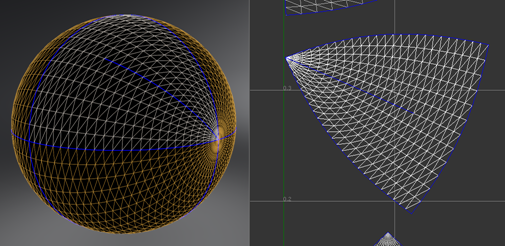

Sew Edges
There are two ways to sew edges: sew along borders or sew neighboring islands.
How to Sew Along Borders
  1. In the UV Editor, select Edges Normals on (Select Edges) and select two or more border edges to sew together.
    Tip:
    Check Only Select Borders when selecting borders using rectangle selection.
    Sew Along Borders
  2. In the Selection Mode section, click Sew Edges.
    If sewing is successful, a border edge becomes a normal edge.
    The UV coordinates of vertices on both sides of a border are averaged and used as the new coordinates for the sewn vertices.

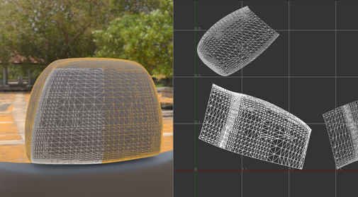

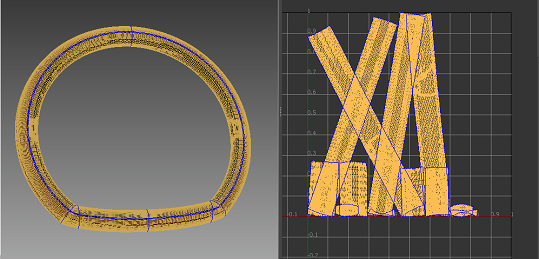

How to Unfold a UV Mesh
UV coordinates can be created by unfolding a surface in 3D space onto a 2D plane. Each UV island is an isolated and detachable piece, so it is the basic unit to perform unfolding.
The quality of unfolding depends on how easily each island can unwrap onto a plane. A relatively planar surface is usually easy to unfold and produces a good result. On the other hand, a surface wrapped with a lot of tension is tricky to unfold and usually incurs a lot of distortion. Experience and effort may be needed to cut and sew the surfaces before unfolding to achieve a satisfactory result.
How to Unfold All Geometries
  1. Select the geometries to unfold.
  2. In the UV Editor, click Unfold & Layout.
    VRED attempts to pack the UV islands belonging to the same geometry into the unit UV space after unfolding.

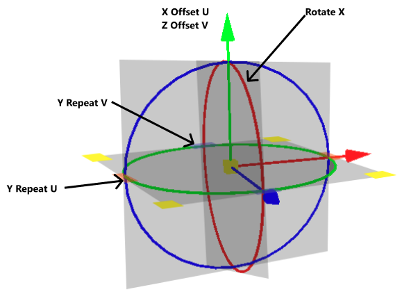

When working with textures, to fix their projected placement, use the tools in the Projection section. The mode selected determines the manipulator that appears.
This example of a planar manipulator provides an explanation of what each component does:
Manipulator with components labelled
For additional information on texture projection and the different modes, see Projection.
  1. Click the Project button.
  2. Click Manipulate. A manipulator for that mode (Planar, Triplanar, or Cylindrical) appears in your scene.
  3. Use the various handles to move, rotate, and scale the texture to correct its placement.

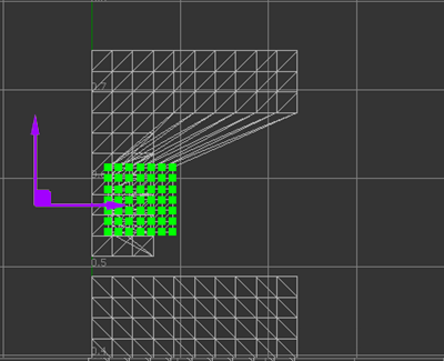

How to Translate UVs
To translate the UV coordinates of selected islands/edges/vertices:
  1. Hold the Shift+W keys to toggle the display of the Translation manipulator. The manipulator displays at the centroid position of the selection.
  2. Continue to hold the Shift key and hover over the manipulator to select one or both translation axes and highlight the corresponding arrow in yellow.
  3. Still holding the Shift key, drag to translate the selection.
    Translate UVs

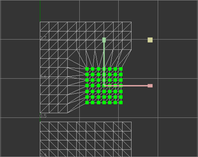

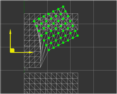

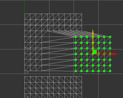

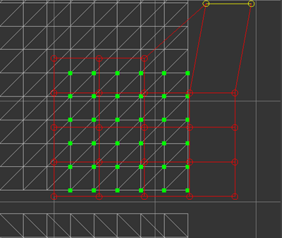

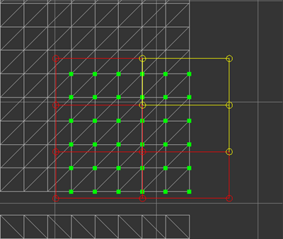

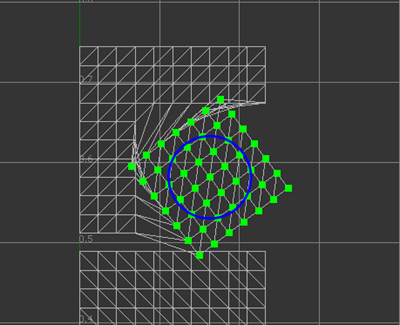

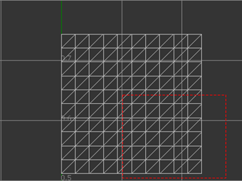

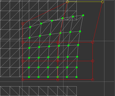

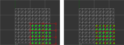

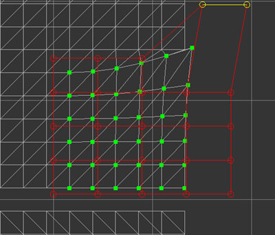

How to Modify Multiple UVs at Once Using Lattice Deformation
Modify the layout of multiple UVs at once, using a 2D lattice deformer.
How to Create a Lattice
Circles represent the control points of the lattice. They are distributed evenly in rows and columns. You can select control points and the lines connecting them. Select and deselect them the same way you select islands/edges/vertices.
Selected control points are yellow. If the two points that connect a line are both selected, then that line is also yellow.
How to Deform UV Coordinates
Select lattice control points and drag.
Columns and Rows specify how many control points each row and column of the lattice has. The more columns and rows there are, the more local the influence of moving a control point.

If a complex surface geometry comes in as a normal triangle mesh, which is one large piece, UV islands need to be created, by cutting the surface, so each can be unfolded. If the unfolding result looks strange or unbalanced, more cuts are likely needed in the surface.
A shell node, which may contain a number of NURBS components, is considered as one geometry node and the UV coordinates of neighbor NURBS surfaces may be sewn together. If each NURBS surface is small and relatively planar, sewing UV islands of NURBS surfaces to form larger islands and then unfolding may be a more efficient way to work.
Sometimes the triangle mesh is completely split. This can be detected by enabling border visualization. Every edge will be drawn blue. If unfolding is done on such geometry, a result like this will be returned.
Important:
Do not use Unfold on a geometry with split triangles. Instead, first merge the geometry vertices by using Scene > Optimize > Unify Vertices. Or, in UV Editor in Select UV Island selection mode, select all islands using Ctrl+A and press Sew Islands.

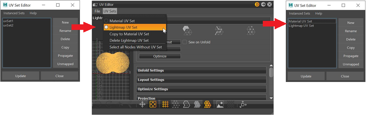

Importing and Exporting for a Second UV Channel via FBX
When importing a model into VRED, using FBX from Maya, Max, Blender, or other DCC (digital content creation) tools, the first channel is imported as a Material UV set. The second channel will now be imported as a Lightmap UV set.
When exporting a model from VRED to other DCC tools, both UV channels are kept and named as they were in VRED. This makes it possible to roundtrip between VRED and other DCC tools, using FBX, without losing the UV sets for the materials (first channel) or lightmaps (second channel).
Roundtrip via FBX
Note:
The DCC can have more than two UV channels. VRED can only deal with the first and second. All others will be lost when exchanging data with DCC tools using FBX.
