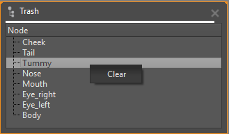

The Trash container contains items deleted from your scene. These can be restored, using Undo. However, you can delete these items from the Trash to clear memory for other processes. Once an item is deleted, even using Undo cannot restored it to the scene.
To view and empty the trash:
To view the contents of the trash, in the Menu Bar, select View > Trash.
To empty the trash, in the Menu Bar, select View > Trash then right-click inside the Trash dialog box and select Clear.
